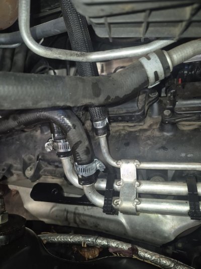

Another Update - Heat never came back and it looks like I was plagued with the all too common clogged heater core. I guess it was triggered by running low on coolant?
Anyway, I flushed the heater core and am 100% back in business.

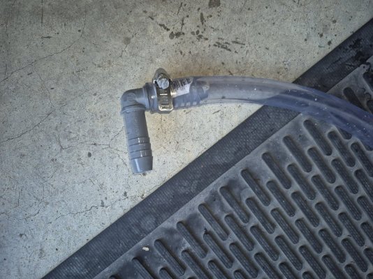

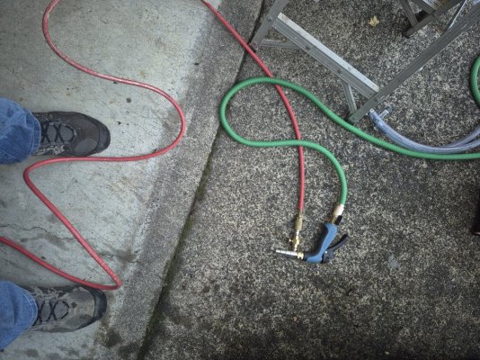

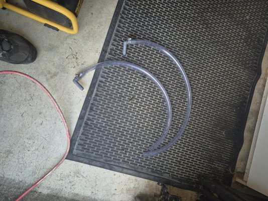

I flushed with a combo water/air gun I got on Amazon for $20 and it worked great. At one point I could feel pressure build back into the hose and I can only assume there was a big chunk of crud trying to work itself out. I was using one of those fabric ultra-expanding/contracting garden hoses which worked great as it backing up is extremely obvious as the hose starts to grow.

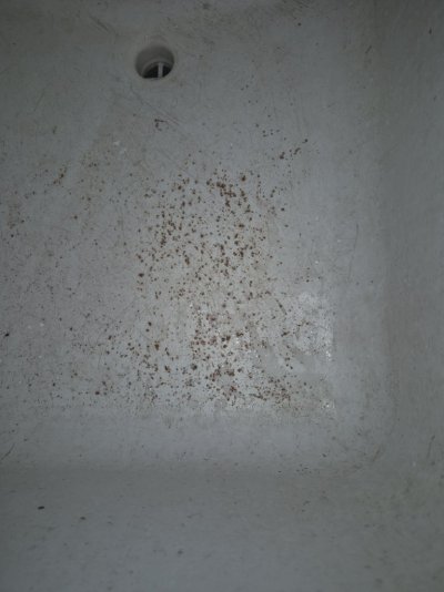

I wasn't really even looking for sand junk but did notice in the sink after dumping the initial pan that I had a bunch (see pic). After the coolant was worked out of the core I just let it empty onto the driveway. I'm a bit of a special case as my engine was replaced at the dealer with a new factory one so I'm unlucky enough to have two loads of casting crap in my heater core.
Thoughts from the job:
The factory hose clamps SUCK and are a nightmare to get off. I fought it from the top for far too long before just pulling the fender liner and getting it from the side. Once I did that it was super easy.
Even with the clamps removed the hoses are a PITA to work free without damaged them. I'm at 145K miles and 10.5 years so I guess that's to be expected.
I ended going with 90 degree elbows for my flush hose to truck heater hose transition. Also, went with 1/2' elbows and they fit beautifully into the 5/8" (inside diameter) truck heater hoses.
I flushed for about 10 minutes in each direction, going between air and water. I set the compressor at 40psi and water whatever it comes out of the sprayer at. Fwiw, the opening on the sprayer is quite wide which results in pretty low pressure. I thought of going longer but with the one big chunk episode I was confident and also didn't want to stress the core any more than necessary. And with traditional clamps on and the hoses freshly removed, the job would be super easy to do over. By far the worst part is re-installing the fender liner.
Overall, super thankful for the info here and on the net and it's a pretty easy job. I'm really not great working with cars/trucks anymore but got through it (did a lot when younger but was luck to have a company owned truck for 20+ years and never touched it). If you have a decent set of tools and even some basic mechanic skills you can get through it.

Glad to hear that worked for you as I'm about to the same thing this week. Same symptoms as you on my 2015 2500. Max 100 degrees out of the vents right now and I'm tired of relying on the heated seats and wheel to keep me from freezing in the winter. Great tip about pulling the fender liner, I was not looking forward to fighting with the hoses up at the firewall.

did you flush so you could see debris? See sand?
I'm not sure if I saw any running through the hoses as I was doing the job. I purposely bought clear hose in hopes but it was hard to distinguish between air bubbles and sand/debris. Also, in reports I read online, people weren't able to see or recover much of anything so I didn't have high hopes. Finding the crap in the sink afterwards was kind of on accident.
When I first looked I thought it would be easiest to get to the hoses right at the firewall but I quickly abandoned that. Those factory clamps are just a nightmare to deal with. Maybe I don't have the latest/greatest tools for them?
Anyway, I just can't see how this is possible w/o pulling the wheel well guard and going from the side. Once that's out of the way everything is just right there. If you're sourcing supplies I bought 5 feet of clear hose and cut it in half for 2.5/each. It worked but I'd go for 8' for 4'/ea side if I had it to do over. I ended up getting wet from the hose flopping around. 4'/ea side and I'd have been able to pin it on the ground with my foot.
I hope I didn't beat up the hoses too bad getting them free. I guess time will tell but so far everything looks good and no leaks. They looked okay but between the dents from the factory clamps and the damage I did twisting/freeing them with pliers I'm going to keep an eye on them.
