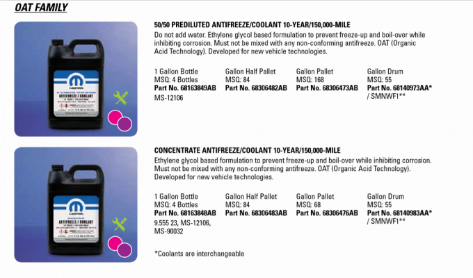

Some time ago I purchased Mopar coolant (68163848AB). Want to make sure I can use it in my 2016 1500 Ram 5.7L .I guess the part numbers have changed.

The 16 takes the 10 yr 150K coolant, not the 5 year 100K coolant. Very different and if mixed a disaster. Get the correct coolant. I opt for the full not the pre mixed as I need below -35° protection.
You will be able to tell the difference by color and price
Your part number appears correct for the 10 year

This video was made by Mopars Training Center
It starts off by stating that Mopar switched to OAT in 2013
I challenge you to stop the video & show me where it reads OAT on the front of the jug
i am not sure that the Mopar OAT Coolant has OAT written on the jug anywhere, they just write the MS- *****
They are messing up by making a simple omission
All brands make the customer research the spec & that is not the proper way to do things

Owners manual
Your vehicle has been built with an improved engine coolant (OAT coolant conforming to MS.90032) that allows extended maintenance intervals. This engine coolant (antifreeze) can be used up to ten years or 150,000 miles (240,000 km) before replacement. To prevent reducing this extended maintenance period, it is important that you use the same engine coolant (OAT coolant conforming to MS.90032) throughout the life of your vehicle. Please review these recommendations for using Organic Additive Technology (OAT) engine coolant (antifreeze) that meets the requirements of FCA Material Standard MS.90032. When adding engine coolant (antifreeze): • We recommend using MOPAR Antifreeze/Coolant 10 Year/150,000 Mile Formula OAT (Organic Additive Technology) that meets the requirements of FCA Material Standard MS.90032.
