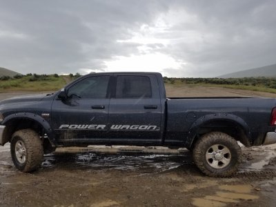

I have a 2014 Power Wagon with 45,000 miles. I want top off the coolant, can I use the Prestone dexcool? It says of course too mopar OAT.
