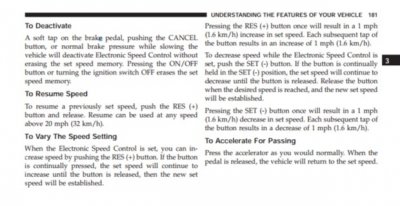

Hi Ledawg,
Pages 179-181 of your Owner's Manual talks about Electronic Speed Control (cruise control), I've attached a screenshot of the section on changing the speed using the steering wheel controls. You can download a copy of your Owner's Manual from the Knowledge Center at www.mopar.com for more information. If you are visiting your local dealership for your appointment next week I'd be happy to follow up with them for you if needed. Just PM our page with your VIN and let me know!

Thanks for the reply Andrea. See the link I have posted. This is exactly what mine is doing. Sometimes I can hit the accelerate button a couple times and it will go. But the 3rd or 4th it will shut down. I was thinking this might be some kind of safety feature. Now after reading the manual it seems to be a problem. Someone replied that there is a service bulletin on this. It this correct? Truck goes in for another issue on Tues so I would like to have this fixed as well. Any help would be greatly appreciated.
