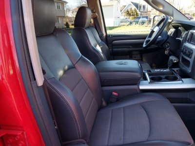

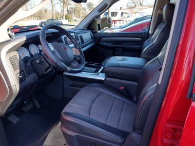

Plug and play. 02-03 uses a single stage (high speed only), whereas 04+ use dual stage (high and low speed). Cruise switches emit the same voltage and the radio controls are the same switches. Just swap wheel, plug in all switches then plug the high speed airbag pigtail into the clockspring and done. I was gonna use a factory wheel then found out Grant makes a nice one, so I went with that. Also got cruise switches from a Chrysler Aspen (the fancy Durango lol) to match the silver accents in the interior. This was when I was doing the interior overhaul, conversion and upgrade last year.

Very nice.
Thought I had read somewhere that the newer wheels were a different clock spring connector or something and the easiest way was to do a full column swap but if that’s the case then I’ll start looking for a wheel haha.
Does that shifter work as well? Guessing it’s a custom job to make work.

They are different because they have two airbag connectors, but the 03 isn't setup for dual stage airbags. I just taped the low speed pigtail out of the way. And yes, the shifter works while sitting in those awesome 4th gen seats lol. No more column shift.

Haha I did 4th gen seats in mine but went with the jump seat console instead, did t want to have to cut things and do custom fab work. I’m lazy lol

I thought about it but I really liked the Ram's head emblem on the lid plus I wanted a floor shift. It'll work out later if/when I get around to the 8HP70 swap. All I'll have to do is modify the cover plate so the ZF shifter sits through it properly.
