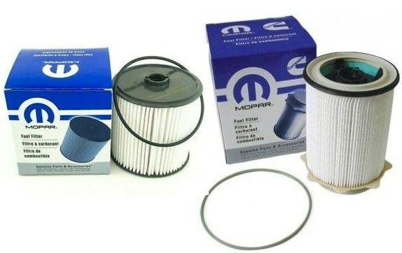

Your DPF will take care of itself as the truck auto regens every 24 hours of run time. But requires some 30 minutes of highway driving. There is no warning this is taking place. It will smell really hot afterwards. The fuel, and oil filters are available at dieselfilter.com. They usually need replaced around 10K miles or whenever your digital dash gauge says zero.
