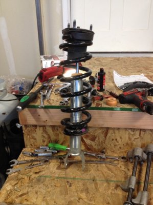

Stock travel front Bilsteins for a 4x4 1500 ram have the same measurements/travel as factory struts. Bilsteins also have a retaining/snap ring that allows you to raise the front up to 2.75" by moving the snap ring up and raising the pressure on the coil. I bought two Bilsteins and had a friend machine new retaining/snap ring groves lower than the OE stock setting (pics). I did one at 1.250" below stock and one .460 above the new lowest one (in case the 1.250" was to low). You can see in the pic the new groves are darker then the original ones. If Groundforce allows their drop to use the same spindle and strut then I should be good to go with CV angles with only going down 2", same concept just different way. If you do this front drop, DO NOT FORGET TO TRIM THE BUMP STOP on the Bilsteins! Lol

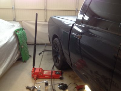

After getting the front squared away I ordered the McGy's #44052 eco drop kit for a 2wd. The kit came and I started with the rear just to make sure it all would fit before tearing down the front. The rear fit perfect and install went good. The instructions don't say you have to do anything with the factory bump stop brackets that are welded to the frame but I didn't like how little clearance there was so I cut out the bracket. There's still the pad for bump stops now, I just removed the holder and gained another 1" of travel.
The front went simple other that the strut nut on top was hella seized and a pain to get off. I started at the lowest grove we machined and figured I'd go up from there if it was too low. After getting the Bilsteins installed and the truck back together, it sits perfect, rides good and handles way better. This was a little more work than just ordering a 2/3 Groundforce kit and tossing it on, but I wanted more drop and I still did it way cheaper than a Groundforce kit, plus I have Bilsteins now! lol, I just have 2wd front coils to sell now...

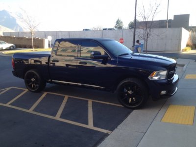

I just finished this two days ago and all I have is dirty pics. Like I said, I live in a blizzard... The clean pic is before the drop, I just cut the rear coils to level it out. It looks 1000 better now, I just need to get it washed! haha

Here's the rest of the pics... Those are the rear bump stops and holder/bracket I removed.

I cant wait to do mine! my kit will be here on Monday so after all the crazy Christmas running around is done, ill get started on it buy the end of the week.
Do you have a dead on side profile pic in before and after stance?

Not yet, the weather has be crazy. It's still snowing outside.... haha, I hate it. I will get some though! soon

no problem, I'd love to see them.
I jumped the gun w/ my post and didnt realize you were still putting up pics .
I saw the first pic you posted of the truck and said to myself, bummer, I was hopping it would've came out lower. And now I see the rest of the pics w/ the real lowered side profile and ,,,,,yup,,,, it sure do look good :)
nice job!

Using the bilsteins was a cheaper way to drop the front with a better strut then stock. If you put the same bilsteins I used in the factory setting with your GF coils you should be just fine. The bilsteins and factory strut share the same length and travel.

Sorry for the confusion, the only clean pic I had of my truck was before the drop kit was installed. On the old setup I just cut the stock rear coils to level the truck out. I did not cut the drop coils, they sit very well already.
My wheels are KMC Slides, 22x9.5 with a +15mm offset.
