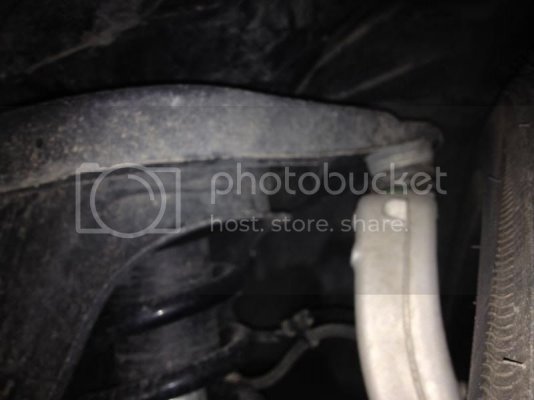

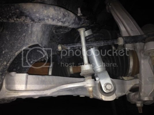

I would still love to see a pic of your upper ball joint angle and your cv joint angle, if you could.
this shows how parallel the cv is stock and how the upper ball joint enters the top of the spindle at just about a straight shot., Id love to see how your method affects these.

Jeff, I picked up the Bilsteins from a buddy's shop. He had them in-stock and he was only $4 more then the cheapest one I found on Amazon. I think $94 each is the cheapest I found online. Part #24-187367...
I finally got a couple pics, sorry they're not the best. I just stuck my phone under the bumper and snapped a few.

thanks, those pics are just what I wanted to see and ill look them over some more later.
