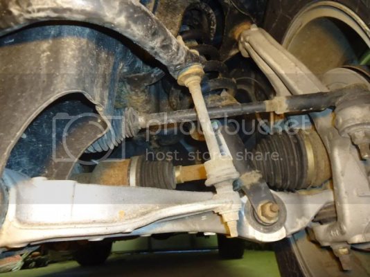

this is w/ everything stock:

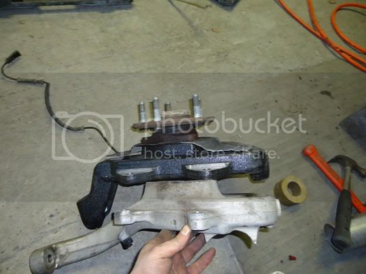

this is the only altering that had to be done, trim the backing plate:
and the side by side comparison:
If you read anywhere that 2wd and 4 wd spindles are the same, they are not! My stck alum spindles are marked 4x4 on them and after just looking up on all mopar, there are two different listings.

4wd spindles and 2wd spindles are different, so I don't know where you heard that they were the same. The 2wd spindles are about 1" shorter compared to the 4wd spindle. They're also good for ~1" drop on a 4wd, so you're already lower than with jusst the 2wd spindle swap.

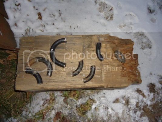

Because the front springs are tapered on both ends, there is only so much you can cut off before the diameter of the spring gets to big to sit on the retainers. Little my little I cut off pcs and would put the shock back together and check the drop.
I ended up removing 1/2 a coil from the top and bottom :)
w/ the one coil removed (1/2 from top, 1/2 from bottom), it gave me the same drop as the spindles, ~1.5"
Plus, my passenger side sat ~.25"s higher so I was able to grind small flats on both ends of the coils to dial that in. Im now ~3"s from the top of the tire to the fender lip on both sides.
coil ended up at 13.5"s from tip to tip

Do you have a pic of the front suspension (maybe w/ the wheel off or turned full tilt) so we can see what your dealing with.
