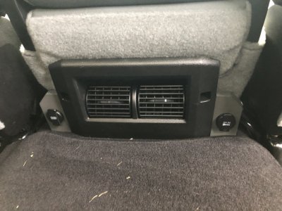

This is just perfect... I have exactly the same setup as you (Crew Cab express)... just got one more question because I'm horrible with this stuff... can I see where you ran the wires and where they hooked up to the power and ground? Also on the link you provided it states it only the left side... is it both sides or just the left?

There are two links there, one for the left side piece and one for the right. To put a port on each side like I did you'll need one of each. I don't have any pictures of the wiring, but it's pretty simple. They run under the jump seat to under the drivers seat. Under the drivers seat they go into the existing hole in the carpet (the one the factory seat wires go through) and then run through the factory wiring channel that runs under the driver's door sill to under the dash. The ground is attached to the factory ground bolt behind the drivers side kick panel and the 12V+ is attached to a wire that I ran through the firewall to the fuse box. I tapped one of the unused (on my truck and probably any unmodified Express) power seat fuses.
Here's a post on how to run the wire through the firewall: https://www.ramforum.com/threads/in...e-plate-for-running-wires-into-the-cab.117923

Thanks brother. so since you ran it that way, the outlet is always on, right? any chance you can show me which fuse it was that you used? I know I'm being a pita just never did this stuff before.

Actually the fuse I used is only on when the truck is. Fuses F98 & F97 are for the front and rear heated seats, respectively. As long as you don't have heated seats you can use either. You'll need a "micro 2 fuse tap" like this: https://www.amazon.com/Lumision-SHIPPING-CIRCUIT-FUSE-TAP-TERMINAL/dp/B00OZFNJI6

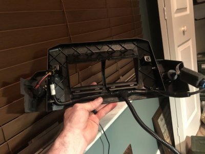

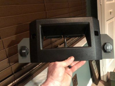

Thank you for creating and sharing the bracket. Excellent job! I ordered a set and got everything pre-wired this evening. Will install in the am. My goal is to try to use factory parts or make is look as factory as possible when doing mods.
I was able to source Mopar parts for the usb and 12v sockets and covers. The holes for the aftermarket were slightly bigger for the 12v socket so I epoxied it in. I also painted them charcoal to flow with the interior of the bighorn interior. Also like you I had to modify the socket due to it hitting the seat bracket. Had to cut it and solder a pigtail on.
Thanks again, super excited about these!

And 10 days later they arrive.
Thanks again OP. Talk about a well designed part. It's very well braced internally. I'll try to get these installed in the next week or two.
