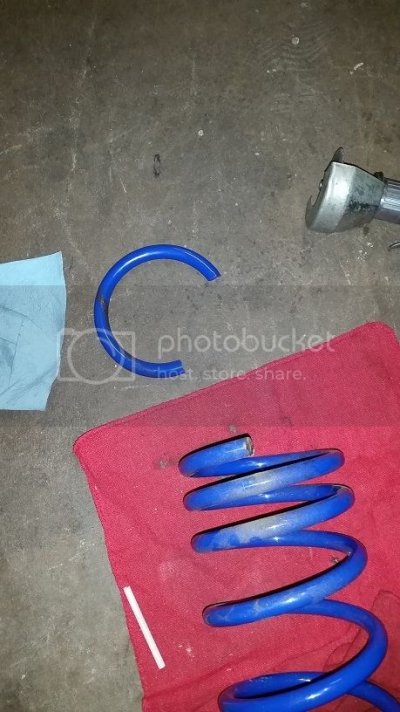

Where I made the cut
How much was cut off

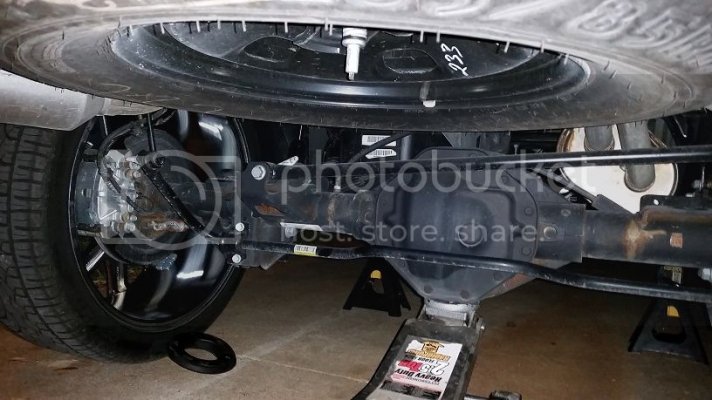

Spring out on drivers side. Lower shock bolt removed. Truck up on jack stands with rear end being supported by jack. Lower the rear end down just enough to get the springs out. You can also see the rubber pad that the top of the spring seats in sitting on the ground in this pic.
Driver side spring still in but with rear end lowered. Just hadn't pulled the spring out in this pic for comparison.

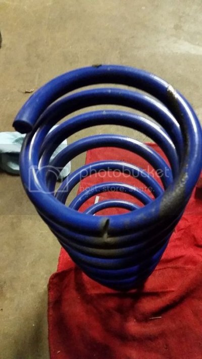

In this pic you can see the spring seated in the rubber pad at the top. Imperative you get the spring back in the grove worn in this pad. Then the pad must be seated in the spring pocket.
shot from inside the spring looking up. spring and spring pad seated in the spring pocket.
