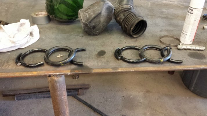

So 2 1/2 coils?
I don't remember haha. The picture also shows how much I cut each time before bolting back together to check height. Just cut small then measure the drop and you'll know much you need to cut.

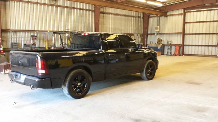

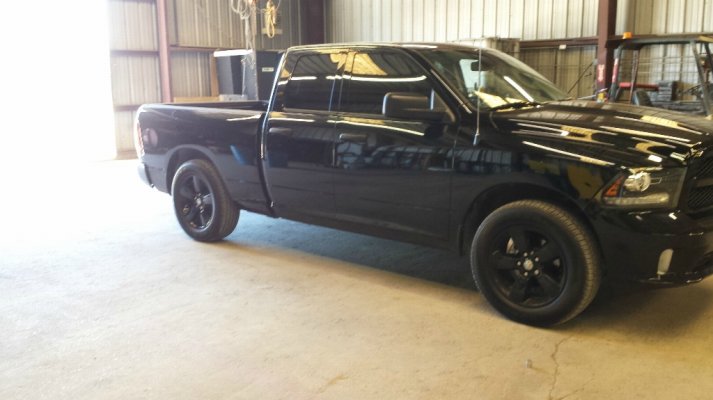

How much I cut/what it looked like after.
Did your coils fall out when up in the air I just cut 1.25off and got about3in rear drop and mine will fall out if jacked up . I'm wanting to go lower but kind of afraid too
Not necessarily fall out but yes they are standing freely until I lower the jack more. Had to make sure they were sitting properly while lowering it slowly. It would be a lot easier with help holding the springs whilst someone lowers the jack.

Did your front lower any going that low in the back, did you have to relocate anything ?
No it was just to level with the front. Didn't have to adjust anything either. No wobble with just a 2 inch drop to level with the front.
