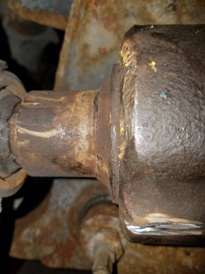

Here it is. Inner joint housing of CV axlef7918aab0dda62e29622f21c660ce322.jpg7f3956fe135166050516a282c462d951.jpg

I wouldn't cut anything off, that housing gives you a place to push against. So the short shaft that goes into the differential is stuck in there correct?

That housing is stuck on shafy

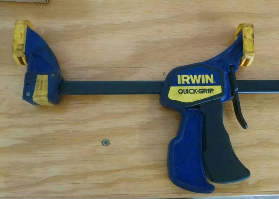

My other suggestion would be to use a few small quick clamps to push against the housing and the differential. a130ac68e156f07b68a10bbdc5c662b1.jpg

Last night I said that's it!!!! So I took my grinder and cut the sucker off. Did same thing as this guy did https://www.youtube.com/watch?v=EU6NX5BU6jU .
I measured clip groove distance from edge of the neck of old one and cut the housing little bit before the clip so I'm able to slide it off then remove the clip and back of piece.
I got tired of all the work I put into it before....slide hammer , home made pullers , bearing puller , crowbar , etc. Tried anything possible and that sucker won't come off. Cutting did the job. I don't care about $5 core charge at autozone. I'm really happy that it's finally off. Since I'm working on the axle anyway decided to replace the shaft seal also. Now I have to get new clip too.

As you can see on the photo below it looks like when I tried to pull off the back piece the clip is pushed upward. Maybe that is why I wasn't able to remove it74a593fc0f072f0b8c285150bc18c2c8.jpg
