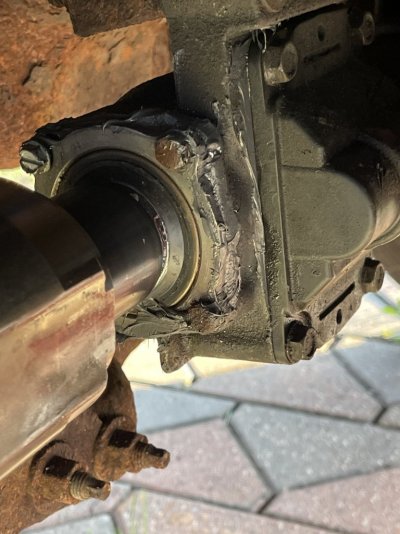

I am the owner of an 07 dodge ram 1500 bought it brand new here in Michigan. I replaced my wheel bearings and driver side CV axle last fall and recently replaced the passenger side wheel, bearing and CV axle for those of you who intend to do this on a 07 and up Dodge ram 1500 Big Horn edition. please note that the driver side, CV joint and the passenger side CV joint have markedly different intermediate shafts at the end because on the passenger side is where the 4 Wheel Dr. for the front locks in, so make sure that you get the proper CV joint intermediate shaft. I thought I had the right part but apparently I had failed to do my research. Don’t want any of you guys think it’s the same. Stay safe, Drive Dodge!!!
