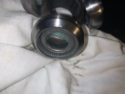

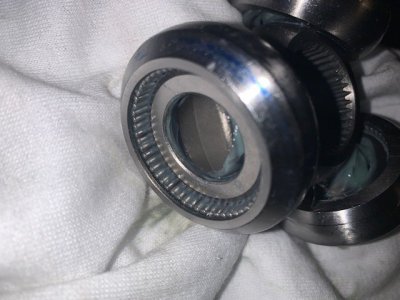

Hi everyone,
Been hanging around here reading mostly but I thought I would share this to maybe get some "gearhead" advice about an issue I had with my 2019 Ram Classic Tradesman quad cab/5.7.
Stay with me on this:
Purchased truck November 30, 2019 (manufactured in October 2019). Had 15 miles on it when I picked it up. This truck marketed as a 2019. Anyway I did a few mods (tailgate assist, step bars, visors) and then I installed a leveling kit (had some so called "trusted" friends do it). Truck ran fine, drove just like it did from factory. A few days after install, cv grease slinging under passenger side coming from inner boot. Of course I almost had heart failure but I decided to just get a Mopar boot with clamps and change myself.
Started yesterday. After I pulled axle I noticed a section of the large clamp was damaged (bent in a tad) hence this was where grease was escaping. I cut both clamps, slid boot back from tripod end, slid bearing assembly out and noticed pins were dislodged from one of the bearings-my heart came closer to failing! If you have never examined this type of set up, then stop reading.
I have ordered another complete axle (OEM) but my biggest question is, is how on Earth could this bearing have just fell apart? I cleaned the entire tripod assembly up and there is no retainer clips on any of the three. Almost like they were pressed on the pinions. My other question is can I purchase JUST this bearing assembly as I could rebuild this axle and have an extra on hand. Ultimately this looks like a defect considering I have 4K miles on truck and have never "dogged" it! Lastly I wonder if there is an axle out there that utilized the "ball" bearings instead of needles?

I’m honestly amused the needles are missing. Any signs of them? Also the bearing race doesn’t look like it has any damage even though the cv is always turning. Could have been when they installed the leveling kit but doubtful. And if you’re running spacers at 2.5” usually the cv shaft isn’t horizontal. I’m at 2.5” lift but it’s a strut lift and my cv is angled up slightly towards the center.

Oh yea I salvaged most of them. But no axles aren’t angled that much at all. I heard a strut lift was better but only because it doesn’t limit travel? Even the geometry of upper bj’s isn’t that much different than before. I did find one pin that was broke in half. I’ll send pics of how it’s situated when I install new axle shaft.
