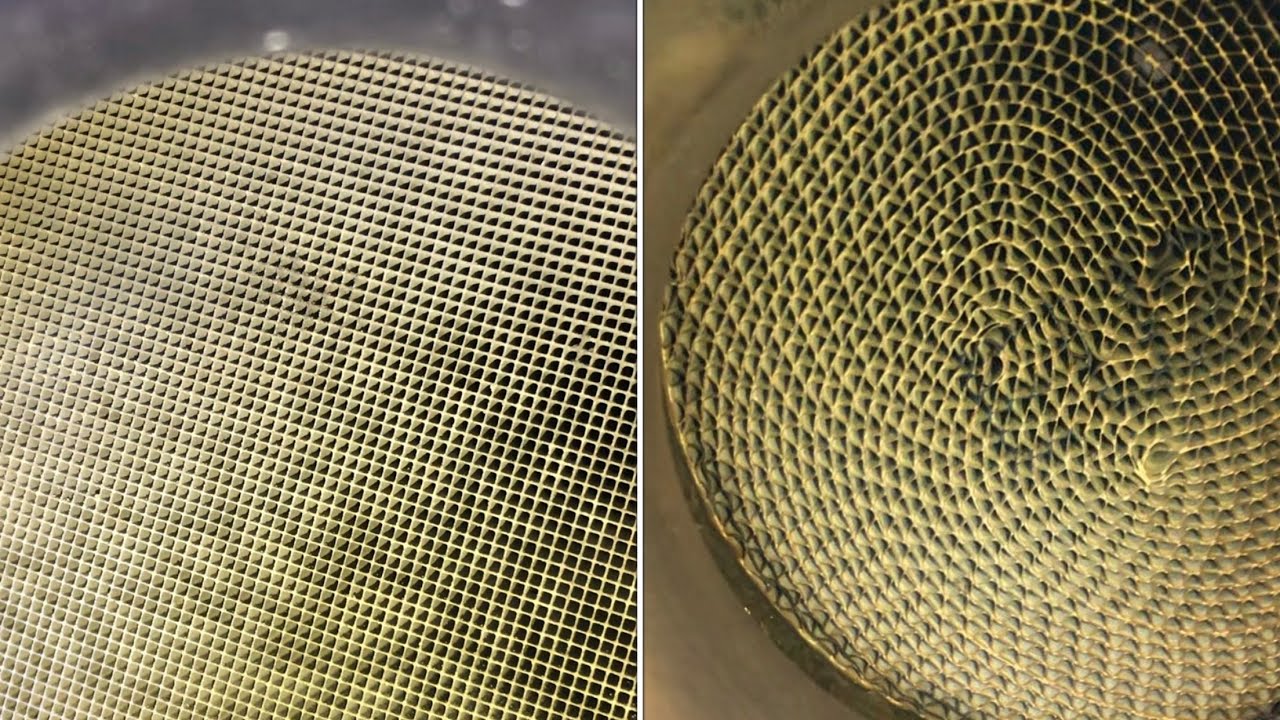

Larger dia pipe will flow more. But there are no high flow cats. I was told this by a guy who’s sold cats for 30+ yrs. They all have the same substrate . So the only way it will flow more air is if it’s a lager dia. However if you put a 3in dia cat on a 4 banger it will never get hot enough to be efficient . Probably never have that issue on a v8 though. If look in/through 2 different cats , say one stock & one somebody says is high flow. Alll the lil holes inside are the same size holes . It not like one a stir stick & one’s a Mciky D’s straw.

You literally can see thru High flow cats my dude, not sure WTF you're going on about.
