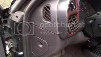

Alright here's a couple pictures of what my dash cap looks like. If you want more pictures or pictures of specific things let me know and i'll get some.

That looks really good.
You can upload them to photobucket and then paste the IMG code here. Saves space

Yeah i'm really happy with it. I recommend it to anyone that is thinking about it. It was real simple to install, fits perfectly over the existing dash and you can't really tell it's a cover even it you look closely at it
