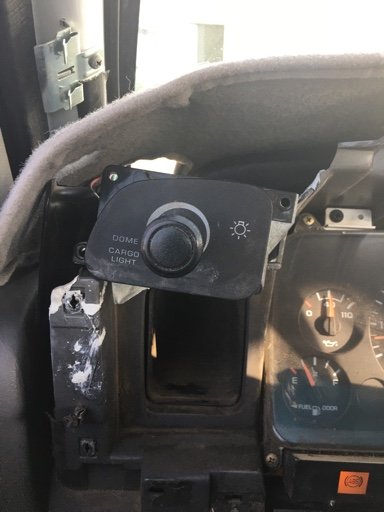

Has anyone managed to re-attach broken bits of their dash core, by glassing or epoxy or plastic welding or whatever? How did you do it and did it work? I have to put back rather important bits and I'd like to know if it's feasible.
Any help appreciated, pictures or video doubly so.IMG_20190328_132406016[1].jpg IMG_20190328_132412639[1].jpg

I believe that your best bet is going to to fiberglass cloth and epoxy. Adhesives won't hold and when the joints do, the plastic snaps elsewhere.
At best a squirt of liquid model cement will hold things long enough for you to cover the area with matting.

This is a pic to show how bad things were when I started!! I had no top dash at all. No radio or hvac mounting.486e90f01b35b245ddbc44e36607f968.jpg20a54f130d8a6464677c65e2c2835303.jpg
