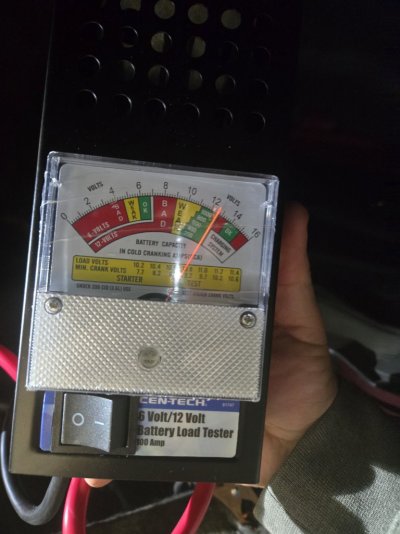

The SOP when dealing with multiple system failures or alarms is to load test the battery with a toaster-style load tester like the unit from HarbourFreight for $20. And, don't let anyone convince you a digital battery load tester works better, they often misdiagnose a flakey cell.

The most relevant picture to display would be during the load test with a notation indicating after x seconds (as per the device directions).
With the load switch off, the meter is only showing the float voltage.
And as 0fxdwgi asked, is that the original battery or the new battery?
