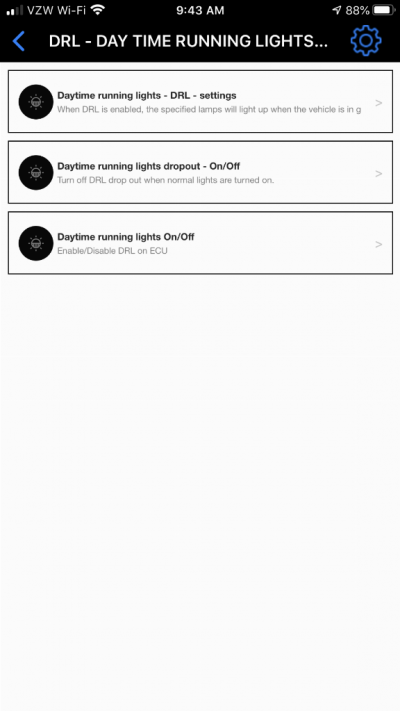

You can have the truck in neutral and the drl's will be on. For truck's with factory projectors they use a dedicated drl feed, which uses the park/turn lights anyway, at a slightly reduce power. If you use alphaobd you can select dedicated for the drl's and be done. If you added oem/tyc projectors using a adapter harness you'd select parking light as drl, which I believe is set at 7.4v compared to the turn signal which is set at 12.2v.

I called my dealer about turning them on here in Delaware. They could do it, for $130. An hours labor charge for 10-15 minutes work. Couldn’t justify it. Through posts on here I found out about the alfaobd and for $60 turned the DLRs on, turned off my fog light drop out with high beams, and did the global windows down (not sure how much I’ll use that last one.)

I don’t know the voltages, but setting the DRLs to turn signal or “dedicated” on mine with alfaobd, they are really bright. Like the brighter level of the turn signal. Same as if just the parking lights on. Those lights are less bright when the headlights come on.

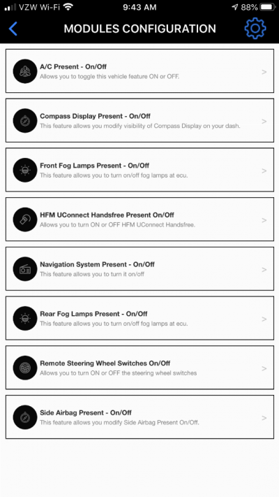

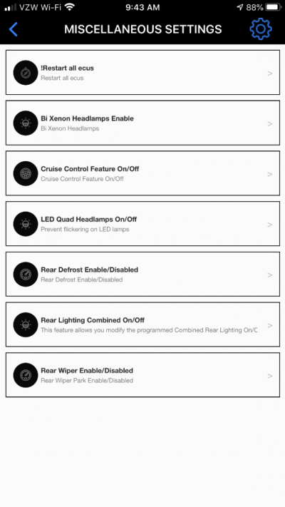

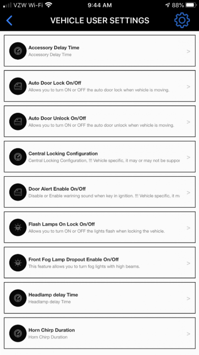

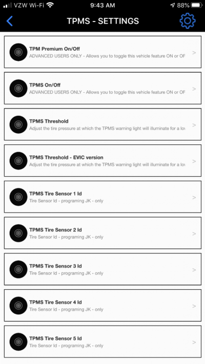

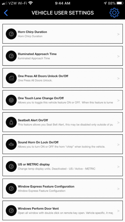

I downloaded the jscan just to see what it is. It only works on 09-12 truck's and has most of the simple changes that alphaobd can do. 17d6d17b83efd02b366235ff17813755.png54061cc60089073443b9507ddbccfe19.png75047d772a002c46c1966f3e7d96459a.png76b34b512ed277025250d086466c8657.pngc358369fe2e4edd11cf7d4d495ad626f.png26f1ca1a86d6739603b195603d651f00.png57a72862fc067f6654d116e59f2ff762.png3148e507694324f9de2f3f9fe9296fdd.png
