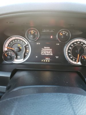

I have a 2019 Ram 1500 Classic
In mid October I went out to start my truck to take my daughter to school and to my surprise it wouldnt start. I look at all the usual things battery, starter, reset the brain, everything I could think of. After about an hour or so boom it started. drove great the rest of the day. Next morning same thing happened, I took it to the dealer and after 4-5 days they said your truck is fixed ....(valve body replacement). I said cool went and got it. Two weeks later it happened again same thing everything worked just wouldnt crank at all said I need to have my trans and electronic breaks serviced. So they towed it in once again and now th ey have had it for 6 days and counting. They still have no clue whats going on. i bought it September 1st less than 3500 miles.20191113_082847.jpg

So I got a message from them yesterday saying the VALVE BODY they just replaced was bad im worried its something bigger causing this two valve body the replacement with less than 500 miles. anyone know what could cause this to happen

Ok guys, so i just got my truck back and they actually did some investigating into why the valve body would be bad turns out it was the 34way wire harness the connector was broken and wasnt making a good connection. Lets hope this was the fix and i have no more issues.thank you @RamCares and @G-Ride990.
