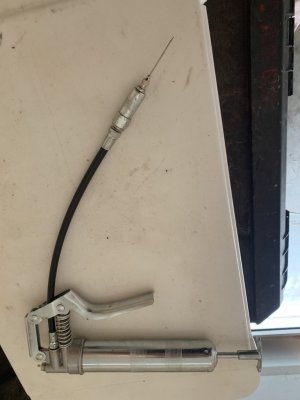

Get the geese fitting that looks like a epidermal needle. The thing is huge. It’s what I used.

I grabbed my needle from auto zone. It’s cheap.

The last time I ever did mine, I had a buddy help me, I held the light, and found the dimple and put the needle in and had him pump so I could watch for grease to come out and say stop. It was a lot easier with two sets of hands.

is lincoln lubrication 5803 grease needle what I need? Its what popped up on a google search for "ram grease needle"
My 07.5 4x4 never was greased in the 165k miles that I owned it - but Im going to try to take care of this for the 16 I have now.
What grease? general purpose lithium?
I purchased a few tubes of (Red) synthetic Amsoil grease at a local garage sale down the street a few years ago.
I’m sure a good quality lithium grease would work.
In my mind —-> Any kind is much better then dry with nothing at all to lubricate those needle bearings.
My set up is extremely similar to 22hemis. The hose gives you flexibility to maneuver around the wire harness.
Like I posted above: A good bright light is very helpful.
With a properly equipped & working grease gun - 1-2 pumps should be efficient.
If the knuckle is dry it might take 3 pumps to get new grease to ooze out the backside.
I don’t really need/require 4WD very much in our region.
Only really during the winter months (Snow/Ice). It is really a life saver 1 or 2 times out of the year - hence the reason I have always owned a 4WD truck.
HD2500 & Anti-Slip rearend with 300lbs worth of sand bags up against the tailgate really helps with not needing 4WD most of the time with Snow\Ice.
Having new AT tires is a Huge plus as well.
Logical Common Sense tells me —->Since (my) drive shaft is only turning - while the 4WD is actually engaged & I only have to engage the system 2-3 times a year for short periods of time I really don’t have to pump a God Awfull amount of unnecessary grease into the knuckle that’s Not Turning very much at all during the year. :cheers: :waytogo:
Maybe just give it one pump before every winter.
