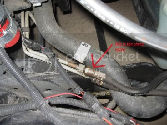

Hold on, and I'll post my pic of it...if you have it, you need to ditch it first...they are a known to clog up and make your trans overheat.
Now, when I had my trans rebuilt in my Gen2, the trans tech told me a deeper pan wasn't necessary, cause it wasn't a built trans. But, he would not warranty the trans unless I had him remove that check valve and run an aftermarket cooler.

hmm...I am sure it is still there...how do you go about removing that?
a cooler has been on the list, maybe I should do that vs a deep pan.

Cody, the only steel deep pan I know of is a Derale, and it should come with an extension. You can buy them seperatly. I don't believe the pan made a huge difference on my truck.
I've also removed the check valve and have an aftermarket cooler. Those probably helped. You want the biggest cooler you can afford.
You can remove the valve and replace it with a male inverted flare to pipe thread, then pipe to hose fitting. Cut the valve from the hose and feed it on the barb then clamp it tight!
