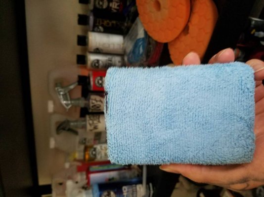

And I only use the PC for the compound/polish. The rest I do by hand with microfiber applicators (pic) which I also bought from chem guys 4a8e4b036fdc895dfad033a25b94ed66.jpg

If you get the MF applicators they are cheap and I bought I think a pack of 12 from chem guys for I don't remember how much but it was cheap.
