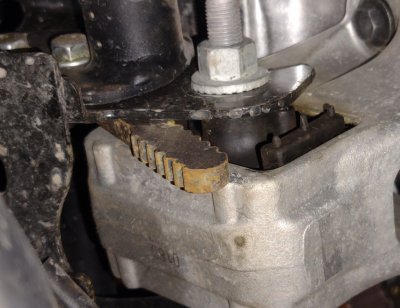

Hey crew. Just installed a Dethloff transmission skid on my 2020 PW. Nice piece of kit and quality is top notch.
I have noticed a small grumble or vibration since, especially when in reverse? I know this will sound weird but almost like the transmission is slipping, which I know it's not but thats the "feel". I'm wondering since the front mount on the skid are tied to the engine mount and these trucks have all sorts of vibration control on them could this be effective that? Anyone else installed one of these and notice similar results?

Hey guys! I want to check into the vibration thing, and answer the timing/communication concerns here, very valid!
Per the vibration: A few years ago Chrysler changed the motor mounts on the 6.4 Hemi to a larger version and I changed the mounting on one of the engine mounts to using an in-house machined nut-plate rather than nuts. This gave more clearance away from the motor mount and made installation way easier. The plates are machined out of a high-strength steel and the threads are cold formed rather than cut, super strong component! I believe I have had one prior instance of vibration from a customer with the nut plate, and I can't remember now if it just went away for that customer, it's been a while. I'd keep an ear out for it and see if you notice anything new. It's likely that putting the truck in reverse loaded the driveline up just right to make the metal motor mount housing touch the nut plate; if that's the case it's harmless but could still be a nuisance as you noted. If you can peak inside the space between the nut plate and the motor mount and see if there's any contact mark, that would help!

Thanks for the reply Marcus. I had the truck in the shop earlier this week for a radio replacement issue and asked them to check out the rear end/new vibration noise. They did a full inspection and found everything to be okay. I have also noticed the vibration has gotten better. Where I once felt it on flat ground I only experience it when backing up my driveway now.
So yea, kind of what I thought all the anti-vibratin stuff on these trucks with the motor mounts are just giving it a weird load/vibration? The dealer said it would not effect anything on the truck and as long as it doesn't actually bind its not going to effect anything.

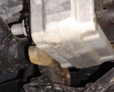

seems like mine rests on the plate all the time. Is this your latest nut plate? DBC2BC2D-507D-433F-8361-BBAB973A5979_1_201_a.jpeg
