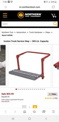

Go buy one of these truck service steps at Northern Tool or online.
Very useful as I found a step ladder to be in the way on the sides.
This service step adjusts and goes over the tire to hold it on.
Also buy a fender cover to keep from scratching your paint.
It folds up nicely for storage and doesn't take up a lot of space and can be easily packed and taken along if needed
