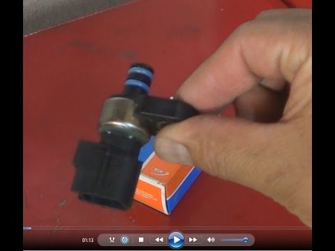

the P0171 and P0174 codes are likely unrelated to the transmission codes.
It sounds like the truck has some transmission issues, as well as the fueling issues.
The P0171 and P0174 codes indicate the same condition on both banks of cylinders. This likely eliminates things like injectors, spark plugs, etc. I would start looking for things that are allowing too much air, like vacuum leaks, loose or broking vacuum fittings, loose intake manifold bolts, or, things that are restricting the flow of fuel, such as a bad fuel pump or clogged fuel filter.
As to the transmission codes, I would start by crossing my fingers, saying a prayer, then replacing the transmission fluid pressure sensor. Hopefully, the sensor is bad and the actual line pressure is fine. Otherwise, it might start getting $$. If the transmission has been working well, shifting good, etc, then the sensor is probably bad. Actual low line pressure would likely manifest in shifting/slipping issues.
The line pressure sensor isn't hard to replace.
