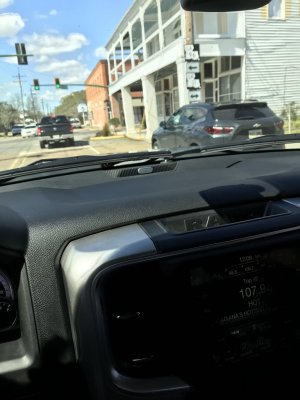

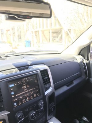

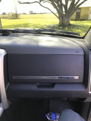

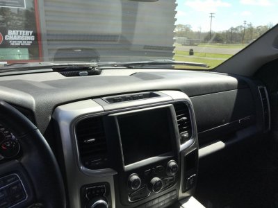

I've been wanting a leather dash for a while but i just can't justify spending 800+ on it, so i just decided to dye my current one black for the mean time. heres some pics. ill make a youtube video later.

Looks great. Will be interesting to see how it holds up. I used that vinyl / fabric paint on my glove box door because i replaced the tradesman cubby with a junkyard one that was brown. It has held up well.

Looks real good. Made a big change.

Wow, looks awesome. Are you gonna do the pillars too? Be sure to update when you do the YouTube video I'd love to see it.

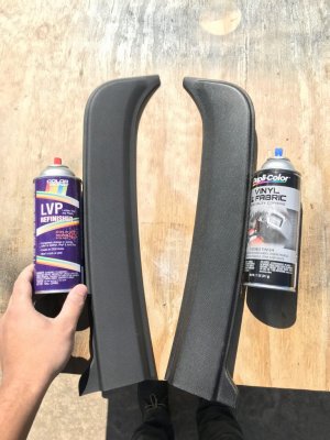

Colorbond Lvp finisher.. here is the difference between colorbond and duplicolor vynl and fabric in flat black... i will be using the duplicolor for my headliner but that is the only thing i will be using it for. The colorbond gives a nice oem black, duplicolor even though its a flat black its looks to glossy for me. colorbond.jpg

Colorbond Lvp finisher.. here is the difference between colorbond and duplicolor vynl and fabric in flat black... i will be using the duplicolor for my headliner but that is the only thing i will be using it for. The colorbond gives a nice oem black, duplicolor even though its a flat black its looks to glossy for me. View attachment 196700
Why are you using the dupi-color for the headliner over the colorbond?
