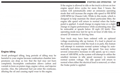

From the '18 diesel supplement (With DEF)
As usual, they use generic terms "Long periods of idle", turbo temp "cool warm hot"
for shut down
