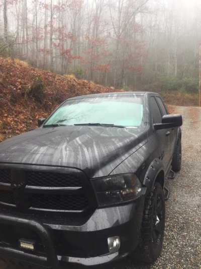

Happy New Years from the smoky mountains c39835eb94feb7c1a86b798df1a2829c.jpg
