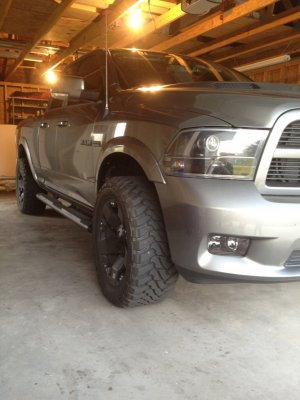

The most noticeable difference in the grill is the bottom corners angle up or the technical term have a chamfer. The grill itself is actually taller also
2011 grill
2016 grill
