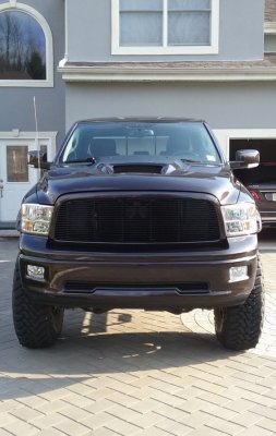

Recently got my 1500 Hemi back with a new lift on it. 6 inch BDS with a 3 inch body lift. That done, it fits my 40 inch Toyos nicely I think. I had all the work done at a shop and they recommended that I swap out the stock 3.55 gears for 3.92s (Nothing taller will fit). They didn't have the time to do them when I had the lift done and I'm due to take it back next week. Thing is, I've been driving the truck for almost 4 weeks now and it drives just fine in my eyes. A little slower of the line, but really not much. If I stomp on it, it goes just fine. I don't tow anything with the truck, and the most I haul in it might be the occasional piece of furniture. I've yet to go four wheeling in it, probably won't. Cruises nice on the highway. Gets up the steep hills by my house easy enough. I really have it for the snow and simply because I like it. Question is this, am I hurting anything leaving the stock gears in it? A mechanic I trust said he wouldn't touch it if I'm satisfied with the performance. He wasn't aware of any harm that leaving it stock would cause (I just wonder about stresses on the drivetrain). Always looking for a second opinion, does anyone have any thoughts on it? Thanks in advance for not beating me up too bad.

In theory, it will stress your trans more and make your engine work harder than it would otherwise. In real life, if you can't notice any issues with it, I think it would be fine to leave it. 3.55 to 3.92 isn't a huge leap numerically anyway.
Now, as for your truck, that thing looks nice! Love the lift and tire set up.

thats a beast! where in jersey are you? id honestly like a ride in your truck if your not too far. im installing a 6" kit right now and already have the body lift and bils.
I was thinking just go 37s, but it 40s work fine i would do it in a heart beat.
oh and also you have a 2010 you can easily do 4.55 gears

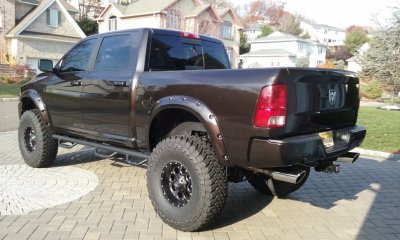

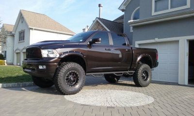

Here are a couple more pictures
