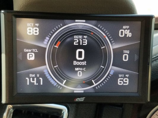

Edge 84030 Monitor
I used an Edge CTS2 monitor in my 4th Gen diesel. They ain't cheap but they work great. Take a look at the linky. I liked it as it has a configurable display with warning set points for most functions.
Unfortunately, oil pressure is not one of the PIDs reported through the bus as @HemiLonestar mentioned above. That would affect seeing such info on any monitoring device.
A mechanical gauge would work if you really wanted oil pressure monitoring.
