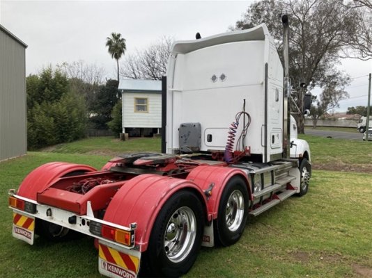

one possible answer is called a pogo stick
you fasten the base to something on your truck bed OR ?
it is a pole that has a spring just over the base & it has a pole rising out of the spring, at the top there is a type of clamp that holds semi truck air lines.
It holds the slack out of the way, until the truck makes a turn & more hose is needed & the spring allows the hoses to straighten out until the excess hose is no longer needed
basically, you have seen Off Road Vehicles that have long CB antennas.
I would think you could use that cb antenna spring to do the same thing

Thanks for your response, GTyankee. The problem with those type of spring devices is that the springs would be too heavy duty for the video cable. It's wrapped to be "weather proof" but it's not very substantial like an air hose on a semi would be. I'm actually going to try heavy duty rubber bands in series. Haven't gotten to it yet as it's been so frigid outside. Supposed to warm up in the near future so I'll give you a report.
