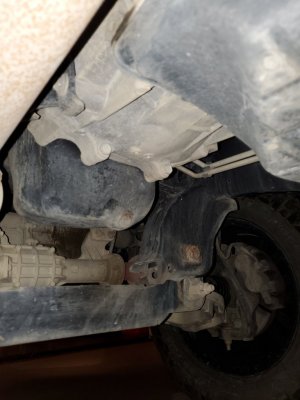

As far as your lift removal goes its only the bracket on the drivers side that was cut. You'll be able to fab a new bracket pretty easy. The control arms are not effected by it. If it were my truck I would trace the passenger side bracket, remake it. Cut the drivers bracket clean off and weld on the new bracket I made. Then you can re-install your brace

Both sides were cut. I still have the rear-most bracket on the passenger side. It only required cutting the front side for the axle.

My bad. It was a quick look at my pictures. Not the axle in the way. You'll see on the front side of the bracket its cut off.
