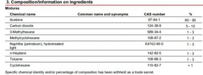

For the life of me cannot find a chemical composition sheet for the mopar throttle body cleaner. But FFR has a point, they are different chemically here is the CRC sheet on TBC:

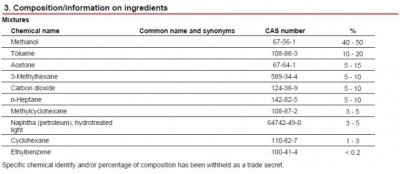

Here are the ingredients of brake cleaner:
And here is a "carb cleaner" that a lot of mechanics use for throttle bodies:
Looks like the TBC is mostly acetone.
I still don't think you have ruined your throttle body by using brake cleaner if you have, actually I'm quite sure or none of the cars I have owned in the last 10 years would have run afterward. I'm also convinced you could use mopar TBC on a ford if you saw fit. I plan on using CRC on my Dodge!
