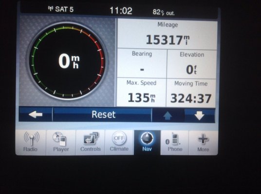

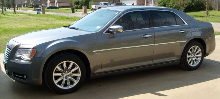

I found out several years ago, the factory likes to reduce torque to keep wheel spin under control. My 2011 300C was not that impressive when I first got it despite having the 5.7 in it. A tuner made it a completely different car. After the tune I could easily light the tires and the down****s were way crisper, not to mention eliminating the slight throttle hesitation. Best money I spent on that car.
