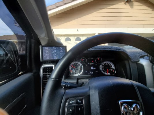

Yes. I use their 12 item screen as described in the att pdf.

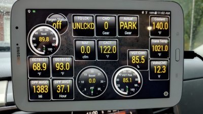

I have not found a way to view current gear without going in the manual mode. I've searched and searched.
You can use an app like Torque pro on your phone or tablet to get information such as current gear. I use mine to view commanded gear, current gear, and torque converter lock status. You may have to find the correct PIDs for you vehicle since not all are preloaded.
Not sure this solution is great for just wanting to see current gear, it's a bit over kill but if you want to monitor several things it works great.

What is the PID you used to see the current gear?
It's a PID I did research on and was able to come up with a custom equation to make it work, it's not a pre-defined one. With that said this is for a 2500 with a 68RFE so not sure it will work on a 1500 with a different transmission?
PID: 22a09f
Long Name: Transmission Gear Actual
Short Name: Actual
Min: 0
Max: 6
unit: Gear
Equation: Lookup(B::0='PARK':255='REV')
