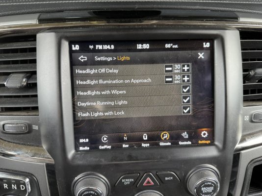

I have installed the proper harness, mirror and have an 8.4 radio. However, I am not seeing the soft button in the truck radio menu. Here is what I currently have as options under Settings->Lights.
# AlfaODB Settings #
Vehicle Configuration 1: Auto High Beam
Select “yes”
Vehicle Configuration 3: Interior EC Mirror Present
Select“yes”
LIN & Misc: Smart Beam Present (AHBM)
Select “yes"
2014 CBC I/O & Features: Auto High Beam Module Location
Select “ECC_AHBM"
Customer Service Menus: Auto High Beam CSM
Select “yes”
Going to try and disconnect the battery for like 5 min and the connect it back up.

I am now getting the option after disconnecting the battery, but I don't see it on my dash display when i enable/disable it. Like shown in Post #10, guess I will see if it works tonight.
You have a Panasonic 4c UAx radio...
(Battery disconnect or pulling the 20A inline radio fuse near the brake booster or Pass firewall ... With these changes is required (Fuse pull recommended) and can speed up the radio/BCM reset for changes, especially with a UAQ/UAS radio (think 15-30mins or longer ... Up to 48hrs).
* Radio is not reset until SXM button displays again and/or Backup Cam works if installed)
Battery disconnect did the trick. My deck is actually out of a 2021 ram. Wanted to have the ability to do CarPlay and android auto
