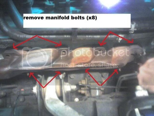

3. Remove the 8 manifold bolts. CAUTION: do NOT force them! If you even BEGIN to shear one off you're in a world of hurt. If you feel it start to seize up, spray some wd-40 or pb blaster in there and re-tighten. Then loosen it again. If it still sticks, spray again and tighten. By loosening and tightening, you're allowing the lubricant to soak into all the threads.
4. Loosen the two bolts connecting the manifold to the pipe. Remove manifold.

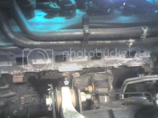

8. Remove headers. (optional: plug exhaust chambers. Do NOT use paper towels or anything else that will leave dust/debris behind) Get some sandpaper (roughly 150 grit) and start sanding. Make sure to get off all carbon deposits (black stuff) and everything else not bare metal. The heads should be shiny when you're done. (the wet spots in the pics are wd-40 overspray from removing bolts before).
9. Spray some wd-40 on a rag and wipe down the heads to remove any leftover dust. DO NOT use an air hose to blow dust off. Doing so will cause an excess amount of debris to go into the exhaust chamber.
