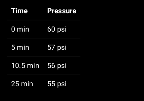

Did a cold engine fuel pressure decay test, so far results are as follows.
So, to me that rules out check valve. Seems to only lose fuel pressure during a hot soak.

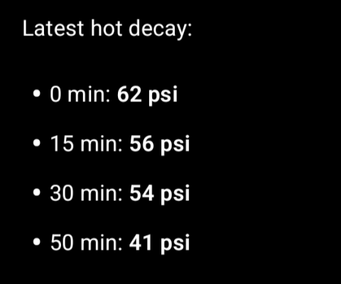

Evap purge valve has been checked. And even replaced. By checked, I mean pulling and disconnecting from system and isolating it/blocking off vacuum lines and makes no difference in fueling.
Hot soak fuel pressure decay is as follows:
Furthermore, doing a clear flood crank, engine partially fired up meaning fuel had been dumped into the ports during the hot soak. So either an injector is leaking, still or somehow the o-rings are questionable. I didn't have this issue again until I changed the injectors and put different o-rings on.
Pull the fuel rail with the injectors still installed in it ,cycle the key on and off and see if you have any fuel drips from the top of the injectors while they're in the rail,and whether you have any drips from any of the injectors
So, no drips from the rail or injectors, fuel pressure drops like a rock when hot. It's dropping from 60 psi to 40 psi in less than 5 minutes.
Put the rail back in and started up just fine. While checking pressure, it seems to be holding pressure now, where before it wasn't. So maybe pulling the injectors out jarred something loose?
I'm going to continue to monitor the fuel pressure drop.off to see if that comes back or if that's gone. If it does come back, I may add an inline check valve to validate the one in the pump going bad.
