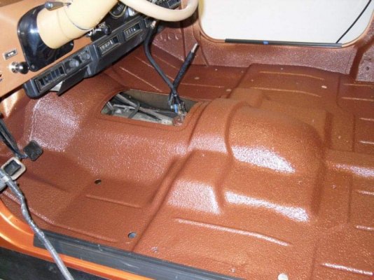

I sprayed the interior of my Jeep with Upol and color matched it. I was happy with it but for my truck, I went Linex for the bed. I think it's more durable than a diy kit and has a lifetime warranty. If it were mine I'd do a professional spray in. They aren't really all that expensive. 8257dc1810aa83dd25bea4730cd4ddef.jpg

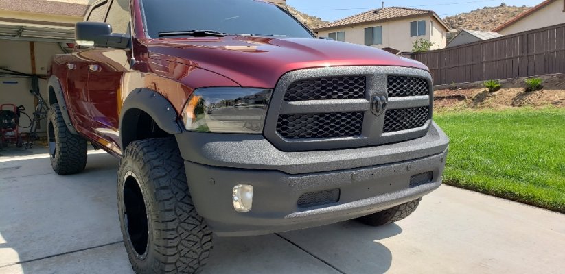

I'm not really picky with certain stuff as i'm with others. I grabbed a bed liner paint kit from Autozone 2.5 years ago i believe it was Herculiner if i remember correctly, it was like $80-$90 or so and it comes in a Gallon of the stuff with a couple of rollers, a brush etc. did it myself, didn't really prep anything in any special way, just a quick wash, quick pass with the abrassive pad that came with the kit, quick wash again, after drying i started painting with the rollers :) hasn't chipped or peeled off and i used my cargo bed a lot, at least for camping gear, tools, etc etc. Had a tonnopro before then went with a softopper since then. The inside of the bed rarely sees the sun so that paint liner should last a very long long time.
