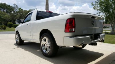

Any pics of the look they gave to the truck
Crown Suspension 1" front, 2" rear drop. Added OEM sway bar, and 4" drop shocks.
If you don't mind, what are your front measurements from ground to fender? And what tire size. I'm running the Crown 1" springs as well, curious how close we are.
How does it ride? Any harsher than stock in the front w/ the Crown springs? Also do you have any other pics w/ it lowered 1"/2"

No, it rides better than stock. Still smooth as silk but much firmer...if that makes sense. I'll see what I can dig up as far as picture. :favorites13:
