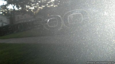

OK. Not B&A shots. Kinda during. I'd be done with the shave but the stupid battery died on my drill. PITA. The Badges came right off. 20# test fishing line and a sawing motion. Easy. The same for the eraser wheel, the adhesive takes very little effort to remove. I do need some guidance on completing the removal. After the badges and adhesive are removed there appears to be some ghosting left in the paint. I picked up some polishing compound (Turtle wax) and a drill attachment (3M Scratch Removal System). Am I going in the right direction?

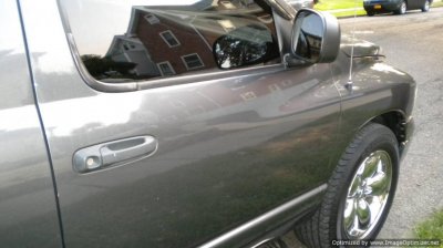

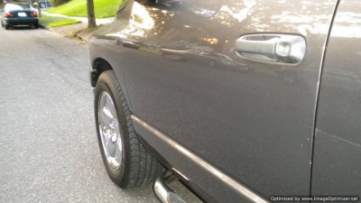

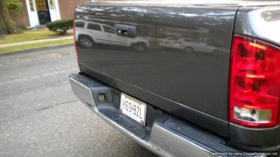

Done
yep, that compound should help to remove the ghosting
Damn Skippy that stuff worked. :) De-Badge complete (had my windows tinted to 20% too). Moving on to the Efan install tomorow. Ya, I know I said I'd do it a couple of weeks ago. Gimme a break. I was researching a 2/4 drop, anda gear kit, anda new stereo (installed already), anda head/taillight kit (HID or not to HID), anda set of lights behind the grill. Oh yeah, the "After" pics are below. This was fun. Expect a ton of silly questions when I do my drop.
