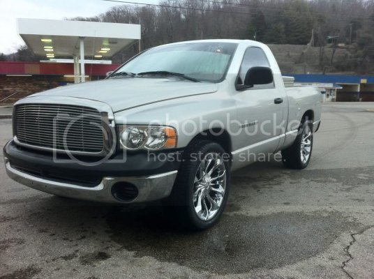

Here is a pic of how it looked a few months ago I've since then added more chrome around the truck but pretty much the same other then the level kit

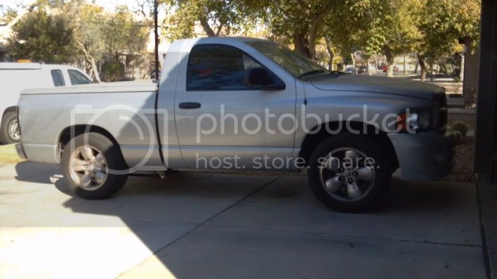

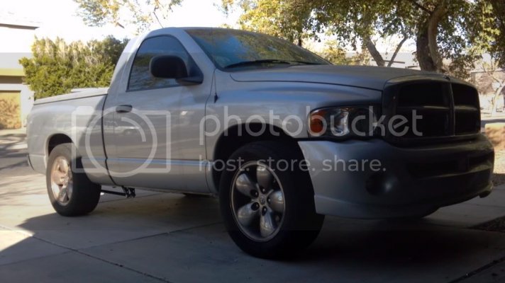

Mine sits pretty nice with the 1.5" drop shackles and the OL removed. One thing I have noticed with the OL removed is it feels like the truck is a little rougher riding than it was.

I had S1S shackles w/ OL removed and visually it was level but cant remember the measurements now since its been so long. The big difference was how easier it was to get in and out of the bed.

Measurements from mineis 36" ground to fender front and back.
