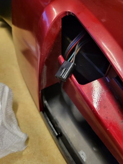

Yes that's the one, wish I had known those connectors have corrosion issues, that's life lol, also wish I hadn't told wife no more mods for a while before I found these mirrors lol, I did find the part on amazon was cheapest, also totally forgot to make sure the mirrors had the temp sensor before I bought, apparently it's not in the same spot as my mirrors, I did find that sensor with wires on Boost Motors

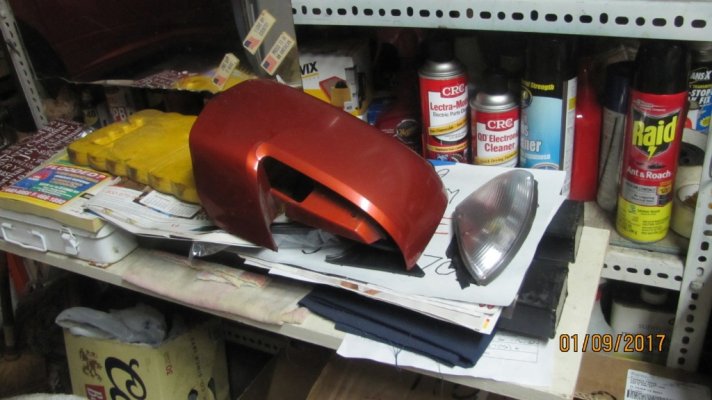

I see that you were able to take painted covers off, I tried but was afraid was gonna break them
Yogee2020
Jan 10, 2021
323
104
New Jersey
5.7l hemi

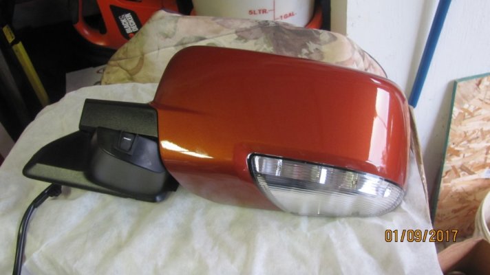

The painted covers r a breeze to take off literally 3 screws and they pop off done mine awhile back
GTyankee
Nov 2, 2020
12,391
17,460
El Cajon Calif. 92021
3.0 ecodiesel

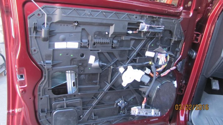

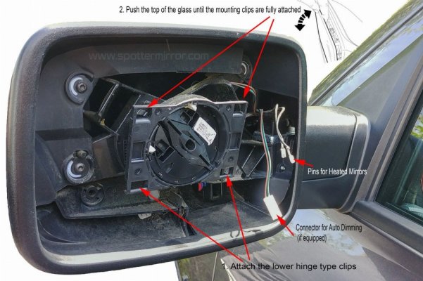

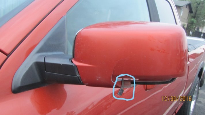

Look at the image that i posted above of a mirror without a glass
you can see the 3 screws
What you don't see is there is a clip, almost dead center of the bottom of the housing
The long RED arrow at the bottom, passes over the black clip
the black clip, i believe is what holds in the Puddle Light.
All of the wires pass through the base of the mirror & they all go to the Door Module.
The door module has 8 female connectors
it will look similar to this

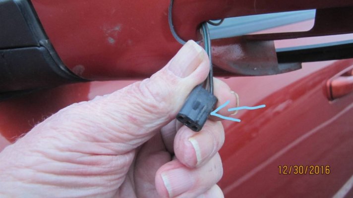

Delphi Metri-Pack 150 Series 3P Connector Kit Unsealed 3 Position.
I bought these for my son's 2011 they worked perfectly for replacing the plug in the mirror for the puddle light.
