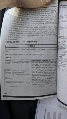

I asked both places about the Mopar BW44-44 transfer case fluid and the Mopar limited slip additive for the rear but they basically said they use an equivalent.
I asked another place about the Mopar additive and they said they have the Napa equivalents of whatever fluids I would need.
How important are the Mopar fluids? I changed my transfer case fluid on my Jeep a few years ago and remember paying a lot at the dealer for the special Mopar fluid.

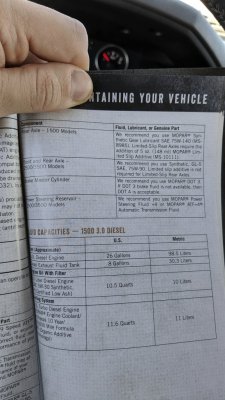

Thanks for the info! So there was no need for the Mopar additive in the rear diff?
Nope. Most if not all synth diff fluids already have the FM additive. It's tougher now days to find synth diff fluid without it unless you go with conventional diff fluid. The bottle will say it contains FM or say something like for LSD applications.
This is what Valvoline prints in the Synpower fluid bottle:
"Valvoline SynPower™ Full Synthetic Gear Oil is formulated for ultimate protection and performance. A thermally stable, extreme-pressure gear lubricant, it is designed to operate and protect in both high and low extreme-temperature conditions. SynPower Gear Oil is specially recommended for limited-slip hypoid differentials and is compatible with conventional gear lubricants."

If it says "recommend" it is not required, IMO. I do not bother with cover removal if there is a low point drain plug. There is no real need to remove the cover unless you suspect something is wrong. Drain plugs on diffs are awesome. I used Mobil 1 gear lube and added some Amsoil friction modifier I had on hand. No issues with my truck with anti-spin over the last 20k miles or so. If you can't find the exact weight lube you can go up or down slightly. 75W-85 can be hard to find whereas 75W-90 is easy to find. If you are truly paranoid about warranty you want to stick with the proper weight and have it on a receipt. I would avoid any quick lube places. The rear diff is very easy to do yourself.

You can get limited slip additive at most parts stores. It says mopar because they can charge more. Get a good diff fluid that meets spec and you'll be good, I recommend amsoil or redline.
As for transfer case fluid, its ATF fluid. You can go to websites like amsoil.com and it says you can use their ATF fluid. The BW-44 case is the one that requires special fluid potentially. Basically take out the fill plug and dip something in. If its red its ATF, if its purple its special. In your case its ATF fluid but you could check to be sure. Some vehicles like Honda Pilot have special rear diff that require honda specific fluid and if you go to amsoil site and search the vehicle, they dont make the fluid so I trust their recommendations. Plus they would have a lot of lawsuits if it wasn't to par.
I don't like using factory fluids because there are way better aftermarket alternatives at better prices.
As long as the fluid you're buying meets the spec you will be fine.
As for transfer case fluid, its ATF fluid. You can go to websites like amsoil.com and it says you can use their ATF fluid. The BW-45 case is the one that requires special fluid I believe. Basically take out the fill plug and dip something in. If its red its ATF, if its purple its special. In your case its ATF fluid.
In case anyone is reading, the BW 44-44 is the one that requires the special fluid.
Yes you are correct, but I was told by my dealer that if you put your finger in the fill hole and its red to use atf. If its purple you're forced to use their fluid.
Amsoil still states their fluid meets the 44 spec. I'll update my post.
