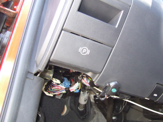

So, just thinking. The Passenger door lock ALSO locks and unlocks all the doors, so why couldn’t it be the culprit? Just went out and opened the passenger front door and, bam, all the doors locked. That’s twice in one day. Pulled the window/lock panel out and look what I found (see photo). There is a wire connected to the gray wire in the factory wire bundle. I have no idea what this may be but I’m betting it’s causing the problem. A few weeks ago I did find a satellite vehicle recovery system under the hood. Upon contacting the manufacturer, I found it was inactive because no one had paid the subscription costs, and I just removed the parts under the hood per their advice. Could this maybe be part of that system? I also have an unidentified module under the dash near the ODB2 port (2nd photo). Could be part of the satellite anti-theft system? Or maybe something else?
Thanks

Thanks Jeepwalker. If you look back at post #13, I think I found the cause. Just don’t know how it’s impacting things.
I had the battery checked at Autozone and O’reilly with their battery checkers and the battery tests good. Not saying their equipment is 100% correct but it’s better than I have. Battery is only 2 years old.
The suspect wire attached to the wiring in the passenger side window/door lock module is the most likely suspect now. I just have to trace it back to its origin point to see just what it is. See the 2 photos I posted.

That device screwed into your dash, is Dodge's after market sensitivity Alarm.
You can adjust the sensitivity to either more or less
That is a dealer installed device, but they have a sub contractor install them.
It is the KARR Alarm
They are at every vehicle dealership, no matter which brand
This is what they put in my 2009 Ram
