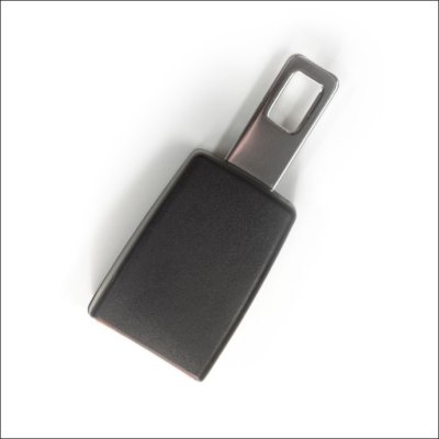

My interior lights stay on and if I can't auto start the truck or move it around the farm without my seat belt on.
If memory serves me correctly, there is a single pink wire that goes to the door latch that is the signal for the door being closed. When the door is fully latched that wire is grounded.
As for the interior lights, turn the dimmer knob to the left all the way, the interior lights will turn off.
To get around the auto-park feature, leave the seatbelt plugged in, you can actually stretch the passenger side one over. I have a 3" rigid seatbelt extension for this purpose, they're about $20 on the Internet.

I use a Seat belt extender, like crash68 mentioned.
This allows me to drive on my property or from the community mailbox up the road, without the seatbelt.
Stupid nannies.
I've owned several of these 3" rigid for different vehicles.

My belly is larger than it should be ..
I bought the 3" rigid seat belt extender, it solved more than 1 problem
i can move my Ram without buckling up :)
It's great for when i position my truck to park it
