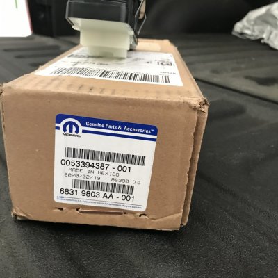

Quick Update:
I received my new door module (68225103AD) from AllMoparParts today and installed it. It made zero difference in performance as the driver and passenger windows still do nothing from the master switch on the driver side. All fuses are good as far as I can tell. I will have to test the switch with a multimeter to make sure that it is not the problem since it is a cheaper aftermarket replacement. If not time to go to the stealership.
Note:
Mirrors -Folding and moving works
Rear Windows - Both Sides Work
Lock/Unlock - Works

Update:
Using alfaobd I was able to read the error codes of the driver side module, radio hub, and passenger side module. After looking at it, there was a communication error. Went to the stealership to get the parts, as my window needed to be fixed due to on and off military installation driving and ID check. Ended up being a fault master window switch, and bad passenger side module. Finally after another $210 I have working everything again. I appreciate everyone who commented assistance.
